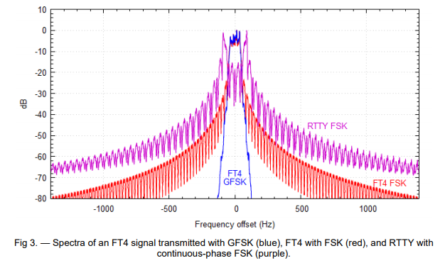

    FT4 can work with signals 10 dB weaker than needed for RTTY, while using much less bandwidth.
    Threshold sensitivity for 50% decoding probability is S/N = –16.4 dB, measured in the standard 2500 Hz reference noise bandwidth. A priori (AP) decoding can push threshold sensitivity down to –18 dB or better.

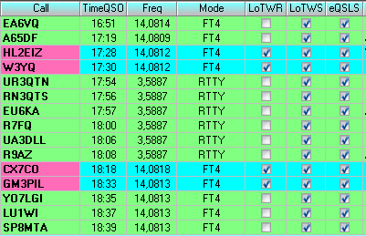

    а как это прописано-это уже второй вопрос (гружу журнал в вот таком виде.
