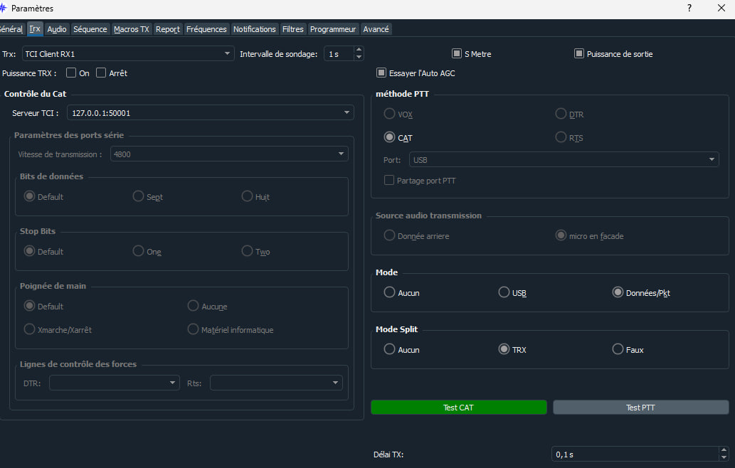

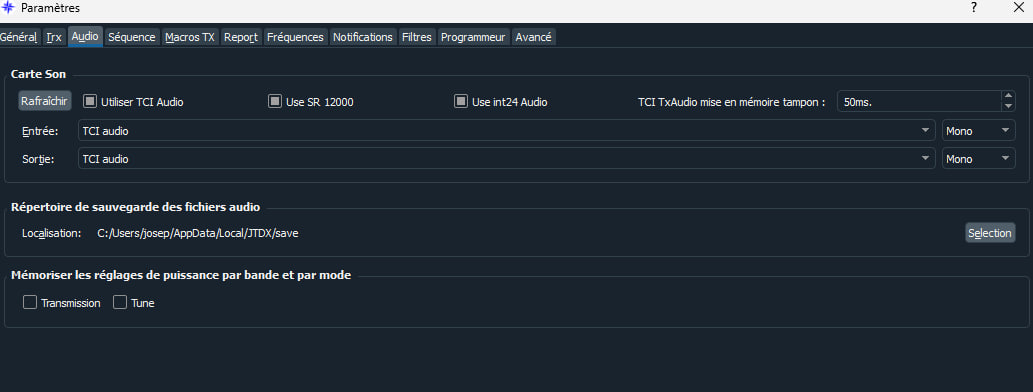

  10. #49
    05.03.2025
    F6CTT
    IN97HV
    2
    Hello all
    a part of my setup with eesdr
    i try to send this image
    Maybe it's OK
    73 Joseph

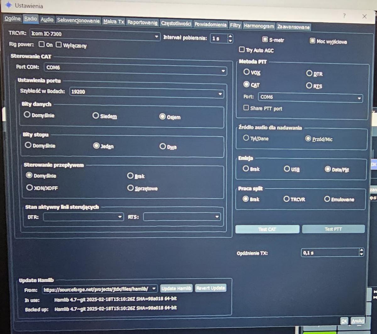

  11. #50
    08.03.2025
    SQ6VRS
    JO80PL
    4
    Audio settings according to your device's sound card. These settings are based on the Icom 7300. I don't know if they will help.
