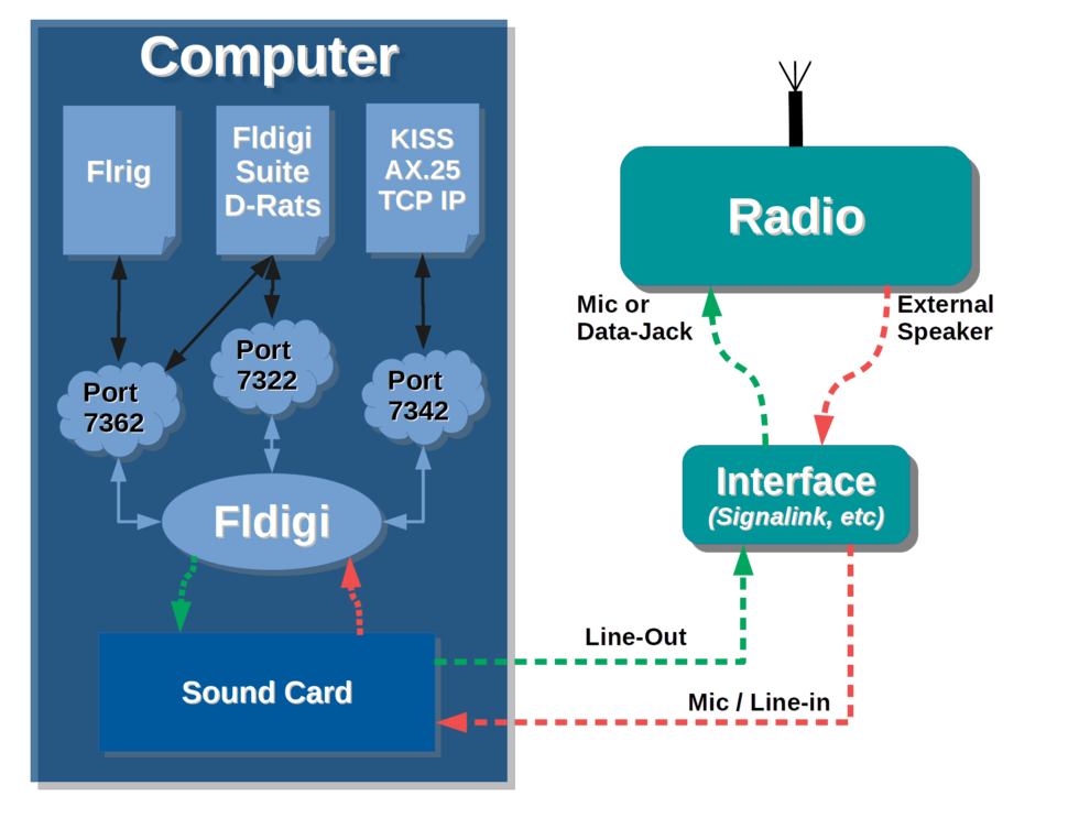

    Software architecture:

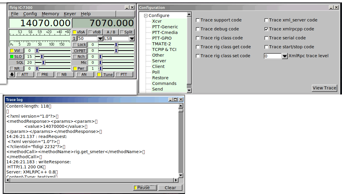

    trace tool:
